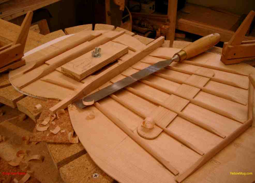

Here is a pic of the bracing I am talking about. Transverse bar 1, 2, and 3 are ordered from the top down.
I've only built classicals but with all the talk of voicing by the steel-string builders around here, I was wondering if much could be done on a classical when so much of the bracing is already 'small'.
Michael... my sizes for the transverse and fan bracing come directly off a Hauser III model guitar. I think he makes a better sounding guitar than his dad or grand-dad, and those are the bracing sizes he uses. I'll let you know how it sounds as my last guitars were true to the 1937 Hauser plans by Brune.

Looks nice. Do you peak your fan braces, leave them more-or-less rectangular, or do you put a parabolic cross-section to them? It's hard to tell from the photo.
I ask because, recently I played a friend's Alvarez Yairi, probably made back in the late 80s, that had this wonderful Spanish sound. I was quite surprised at just how great that guitar sounded. My friend builds guitars also and so we did the old inspection mirror thing. I was surprised to see that the seven fans were quite small and rectangular in cross section. It also had the angled cross brace (just below transverse brace #3) that many classical builders use.
Regarding that angled cross brace, I recall reading that one of the Spaniards likes to use it because it tends to eliminate voicing issues apparently associated with the more traditional 7-fan pattern. I have a theory as to why this is. By installing an angled cross brace, the 7 fan braces are no longer quite so symmetrical -- each has its own length, thus its own inherent resonant frequency, the shorter ones being higher than the longer ones. So it would stand to reason that less work on voicing to bring out the highs, for example, would be necessary. I have yet to build a classical using an angled cross brace, so it is still speculation on my part, but I still think it makes sense.
